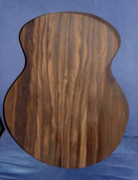

I think you stummbled on the solution, "high heat." It seems the ziricote may need a little more heat than others
When I built this cutaway, I did not have the problems you guys are describing but the wood acted differently than what I was used to. I just spritzed the wood with water, (just to get good heat transfer.) The wood was stubborn, but then, once it reached tempature it became very plastic-like. It was really pretty neat, you could see the water go away and evaporate off the wood and then it bent great. It held its shape really well.

Oh Man that is just awesome John, have you had any cracking like reported by the other builders?? I love the depth of finish on that one... WOW!!!
